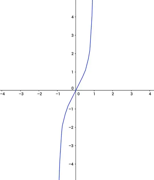

I posted the following answer to your post over here which was later marked as a duplicate of this question. As I take a different (and arguably more elementary) approach than the previous answers, I thought it might be a good idea to repost it for future reference:
You already know that there is a bijection $(c,d) \to (-1,1)$ and it thus suffices to find a bijection $f \colon (-1,1) \to \mathbb R$. The following will do:
For all $n \in \mathbb N_0$ we let $f \restriction_{[1- 2^{-n},1-2^{-n-1}]}$ be the linear function from $(1- 2^{-n} ; 2^n)$ to $(1-2^{-n-1} ; 2^{n+1})$ and likewise $f \restriction_{[-1+ 2^{-n-1},-1+2^{-n}]}$ is the linear function from $(-1+ 2^{-n-1} ; -2^{n+1})$ to $(-1+ 2^{-n} ; -2^{n})$.
The picture below demonstrates what's going on:
