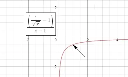

I posted a solution here with an illustration (see below) and commented that the function was discontinuous at $x=1$, where it is undefined. Someone told me, no, it is undefined but continuous.
Now I'm confused.
I would have thought that the point $(1, -1/2)$ in the graph below should be designated with a hollow point (a point that isn't filled in) to demonstrate that that point is not actually on the graph. Furthermore, I thought that this hole would constitute a discontinuity.
If I need to be set straight here, could someone please help me out?
undefined point
MathAdam
  • 3,397
    For sure,it should be marked with a circle because the point x=1 is not in the domain. – Koro Sep 12 '15 at 06:07
  • I added the clarification that someone had told me that it is undefined at this point, but continuous. Wouldn't the circle be a discontinuity? – MathAdam Sep 12 '15 at 06:09
  • There is more to that,even the graph that you plotted is incorrect because at x=1 ,function is undefined so a hole should be there on the intersection of the line x=1 and the graph that u have drawn. – Koro Sep 12 '15 at 06:12
    It has to be a discontinuity.If it's not (suppose) then for continuity we must have value of function at a point= limit at that point. So in the present case, limit exists but value doesn't so function is discontinuous at x=1. – Koro Sep 12 '15 at 06:14
  • @kilimanjaro - That's what I thought. Thanks. – MathAdam Sep 12 '15 at 06:15
  • Welcome! Someone probably confused you. – Koro Sep 12 '15 at 06:16
    What the person could have meant was that the function itself is continuous which simply means that it's continuous in all points where it's defined – Alice Ryhl Sep 12 '15 at 06:44
    Your function is not defined at $x=1$. Thus it does not make sense to say that $f$ is continuous (or discontinuous) at $x=1$. –  Sep 12 '15 at 06:47
  • @KristofferRyhl or what the person could have meant was that the limit exists at $1$. a lot of students (incorrectly) think that if the limit of a function exists at $c$ then it's continuous at $c$. – chharvey Sep 12 '15 at 16:00
