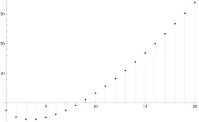

Here is a plot of $\log\left|\frac{B_{2n}}{2n}\right|$
Note that for $n\ge4$, $\left|\frac{B_{2n}}{2n}\right|$ is monotonically increasing as described above, and that for $n\gt7$, $\left|\frac{B_{2n}}{2n}\right|$ is larger than any previous values.
