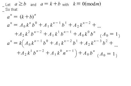

if n is a positive integer let Z be the subset of integer in {1,...,n} which are relatively prime to n
my effort to solve this question enter image description here
I''m confused and need help to solve this question please

    Your current "solution" doesn't seem to be on the right track. Start with the assumption that $a,b$ are relatively prime to $n$. In GCD notation this is $(a,n)=(b,n)=1$. You're required to show that $(ab,n)=1$ which will imply the result. As a hint, you could write the prime factorization of $a,b$ and $n$ – Alex R. Sep 01 '15 at 18:48
