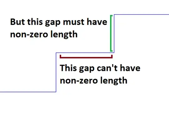

Edit: This image is how I'm trying to imagine it. The blue line is $f(x)$. The total length of the green gaps converge to $2$. The red gaps can't really exist, because the rationals are dense, so I'm wondering if the actual graph when you get rid of the red gaps would look "smooth" or "jagged" (like the Weierstrass function).

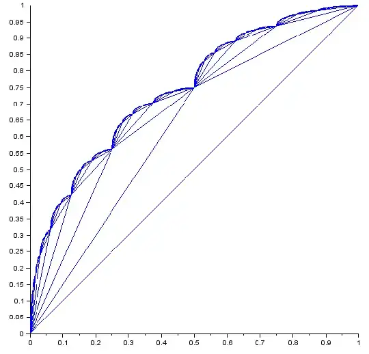

It would be difficult to get an explicit plot of your $f$, since it depends on some enumeration of rationals. Also, the arbitrariness of enumeration destroys any hope for a nice self-similar structure of any kind. If you want a fractal-like monotone function, I suggest a different approach, based on an 1943 paper of Salem: described in my blog post. I think that Salem-type functions are as fractal-like as any monotone function can be.

  • Is it possible to give an explicit plot for some arbitrarily small segment of $f$ that might correspond to an arbitrary enumeration to illustrate the jumps? Could it possibly look like the Salem-type function in your image for some enumeration? I would like to see if it increases "smoothly" like a curve or if there are "corners". Also, if you rotated a vertical gap by 45 degrees, wouldn't there be a horizontal gap of non-zero measure? So how can it be differentiable a.e. after rotation? – ignoramus Sep 03 '15 at 03:55
  • How can a discontinuous function "increase smoothly"? Those jumps you see in the picture aren't going anywhere. Just plot any step function: that's what $f$ will look like on a finite scale. As for the gaps, I wrote in the post : "This requires adding vertical segments at the discontinuity points of f, as on your picture". –  Sep 03 '15 at 03:59
  • Yes I know it can't actually be smooth, I was just wondering if there was a possible intuitive way to see its structure. As for the gaps, I just realised that you meant adding the segments before rotation. (You mentioned adding the segments after you mentioned rotation so it was confusing because it wouldn't be vertical anymore.) – ignoramus Sep 03 '15 at 04:05
