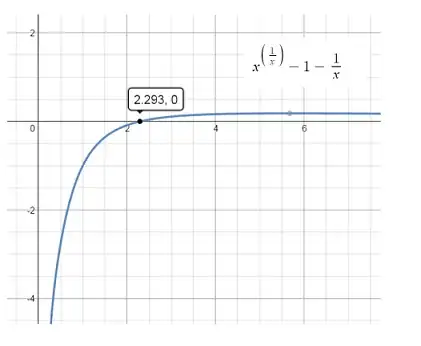

@ Bhaskar Vashishth: If you want a best answer as you comment to Lee Mosher take a graphic of $f(x)= x^{\frac{1}{x}}-1-\frac1{x}$and you can see that your inequality can be generalized to all real greater than $2.293$ for which this function is positive. Obviously, after to see that $(x+1)^x<x^{x+1}$ is easily equivalent to $x^{\frac{1}{x}}>1+\frac1{x}$. I feel all generalization of your inequality has been started from this graphic or some other equivalent.On the other hand, thinking a little about it seems to me that this should be something obvious for everybody.
