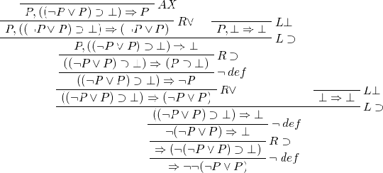

The prover online http://tassi.web.cs.unibo.it/logic/ should help you to understand the intuitionistic proof in sequent calculus (G3ip) for $\neg \neg (\neg P \lor P)$. In fact this formula is provable in minimal logic i.e. a subsystem of intuitionistic logic. Note that the proof below (produced by the prover for G3ip that I just mentioned) does not really uses the intuitionistic absurdity rule $L\bot$ in spite of the use of this label by the prover: it is clear that the axiom $P , \bot \Rightarrow \bot$ is the identity axiom and not the expression of the famous Ex Falso Quodlibet in sequent calculus. Here is the png image of the proof:
Proof in G3ip
(source: philfree.org)

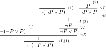

Now the following proof in G4ip (i.e. Dyckhoff's LJT) is shorter:
Proof in G4ip
