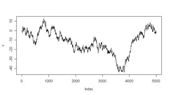

Below is a simulation (in R software) of one run of 5000 steps of the process you specified, in which I chose $r = 1.$ From the graph you can see it is outside $(0, 1)$ after only a few steps. (Index denotes the step $i$.) Sometimes plots such as this one are called 'history plots'.
 r = 1
 m = 5000;  x = numeric(m);  x[1] = 0
for(i in 2:m) {
   d = runif(1, -r, r)
   x[i] = x[i-1] + d  }
plot(x, type = "l")

  • But why's that the position of the particle affects its future directions in a long-run in your 'note' part? – YiFei Aug 18 '15 at 00:20
  • Attraction toward the origin' keeps the variance from going to 0 with increasing numbers of steps. In your model, there is no limiting distribution. The informal jargon is that the 'probability escapes to infinity'. If you are going to examine long-run behavior for symmetrical random walks, it is easier to do for a random walk that goes L or R by one integer at each step. Even there, lots of counter-intuitive facts. (In applications, this is moot; no such thing as a PERFECTLY fair coin in the real world.) Maybe Google 'random walk coin toss Feller". – BruceET Aug 18 '15 at 00:43
