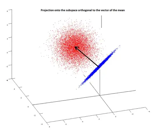

PS: The accepted answer below becomes clear after reading this Wikipedia entry. Also, a plot may be useful including the spherical cloud $(X_1,X_2,X_3)$ (in red) with the orthogonal projection, $(X_1-\bar X,\ldots,X_n-\bar X),$ on the $n-1$ subspace forming a plane (in blue) at the origin:

This can be understood geometrically, as follows: The mapping $(X_1,\ldots,X_n)\mapsto (\bar X, \ldots, \bar X)$ is the orthogonal projection onto a $1$-dimensional subspace of $\mathbb R^n$, and it complementary mapping $(X_1-\bar X,\ldots,X_n-\bar X)$ is the orthogonal projection onto the $(n-1)$-dimensional subspace defined by the constraint that the sum of the coordinates is $0$. Notice that the latter projection takes the mean vector $(\mu,\ldots,\mu)$ to $(0,\ldots,0)$.
The distrbution of $(X_1,\ldots,X_n)$ is spherically symmetric about the mean vector, since it is $$ \text{constant}\cdot \exp\left( -\frac 1 2 \sum_{i=1}^n\left( \frac{x_i-\mu} \sigma \right)^2 \right)\,dx_1\,\cdots\,dx_n. $$
The distribution of an orthogonal projection of this random vector, which projection takes the mean vector to $0$, is spherically symmetric about $0$ in the lower-dimensional space onto which one projects. So let $(U_1,\ldots,U_{n-1})$ be the coordinates of $(X_1-\bar X,\ldots, X_n-\bar X)$ relative to some orthonormal basis of that $(n-1)$-dimensional subspace, and then you have $$ (X_1-\bar X)^2 + \cdots + (X_n-\bar X)^2 = U_1^2 + \cdots + U_{n-1}^2 \tag 1 $$ and $$ U_2,\ldots,U_n\sim\text{ i.i.d. }N(0,\sigma^2). $$
Therefore $(1)$ is distributed as $\sigma^2\chi^2_{n-1}$.
