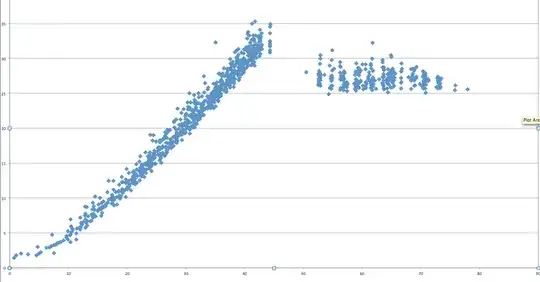

Are there any conjectures from which we can infer something about the first occurrences of prime gaps length $n$ and their distribution? I've made an interesting graph of these values to make this problem easier, with gauss's approximate of their size, $\log(p)$ on the $x$-axis and on the $y$-axis the proportional error, i.e. $\frac{g(p)}{\log(p)}$. A prime gap $g(p)$ is $p_{n+1} − p_n$. What on earth is going on with gaps with error from 25 to 30, why are some of these gaps starting so late, does this pattern continue somehow? I needn't say anything about the nature of the large 'line' but does anyone see the vertical 'wave' like pattern with the anomalistic bunch?
Approximately the first 1000 gaps
I hope this question doesn't come across as too wordy or vague but would really appreciate any general comment.

    Could you explain how you created the graph? If we enumerate the primes, then for every pair $(p_n,p_{n+1})$, how do you decide whether to draw a point, and where do you put it? – Chris Culter Aug 01 '15 at 18:37
    So lets make a set and call it S = {}. A point is drawn if the gap between a prime pair $p_{n+1} - p_n$ produces a value that is not already in this set. Then, we observe gauss's estimate for the prime gap for $p_n$ and put that on the x axis. On the y axis is the proportional error, so the gap divided by log(p) – jg mr chapb Aug 01 '15 at 18:45
    Also it's for approximately the first 1000 gaps – jg mr chapb Aug 01 '15 at 18:54
    Hmm, it looks like the large 'line' peters out around $e^{44}\approx 2^{64}$. It is possible that your numbers got truncated to 64 bits somewhere in your calculations? – Chris Culter Aug 01 '15 at 19:06
