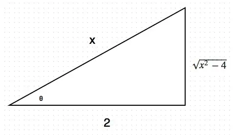

I'm learning trigonometric substitutions and am having a bit of trouble understanding the intuition behind the conversions (why do most use secant?). If you could explain the conversions geometrically using a triangle, that would be very helpful. For example, if we have $$\int \frac{\sqrt{x^2-4}}{x}\,dx$$ I tried to construct a triangle like so:
To get $$\sin(\theta)=\frac{\sqrt{x^2-4}}{x}$$
But this is incorrect for use as a substitution. Why?

The intuition to use trig-sub is because sometimes a problem becomes easier when you make substitutions. Mainly, grouping "nasty" looking quantities into neat little packages can save you a headache. Notice that where you placed the quantities "$2$" and "$\sqrt{x^2-4}$" in your picture were arbitrary. Try switching them and see what happens. Your answer will still be correct.
graydad
  • 14,325
  • Can it not be arbitrary? – John Aug 01 '15 at 16:50
  • @Anonymous No. The only absolute requirement of your right triangle is that the hypotenuse is of length $x$. The other requirement is that the legs of the triangle be of length $2$ and length $\sqrt{x^2-4}$. But at no point is there any reason to believe that $2$ must be the base, or $\sqrt{x^2-4}$ the height. This makes the choice arbitrary. As such you can freely swap the two. – graydad Aug 01 '15 at 16:54
  • I'm still having trouble seeing why substituting sin would be incorrect though if we can freely swap the two. – John Aug 01 '15 at 16:56
  • @Anonymous oh, it's not incorrect. You will get the same result if you follow through with the integration. – graydad Aug 01 '15 at 16:56
  • @Anonymous Also, you did calulate $\text{d}\theta$ right? You have to find a substitution for $\text{d}x$ in terms of $\theta$ if you haven't already done so. – graydad Aug 01 '15 at 17:05

It's not that it's wrong to take on the integral the way you propose -- it's just not awfully convenient. If we implicitly differentiate your substitution equation, we obtain
$$ \cos \theta \ d\theta \ = \ \frac{x \ \cdot \frac{1}{2} \ (x^2 - 4)^{-1/2} \ \cdot 2x \ - \ (x^2 - 4)^{1/2} \ \cdot \ 1}{x^2} \ dx $$ $$ = \ \frac{4}{x^2 \ (x^2 - 4)^{1/2}} \ dx \ = \ \left(\frac{2}{x} \right)^2 \cdot \ \frac{2}{ \ (x^2 - 4)^{1/2}} \ \cdot \ \frac{1}{2} \ \ dx $$ $$ = \frac{1}{2} \ \cdot \ \cos^2 \theta \ \cdot \ \frac{1}{\tan \theta} \ \ dx $$
[using your right triangle]
$$ \Rightarrow \ \ dx \ = \ 2 \ \tan \theta \ \cdot \ \frac{\cos \theta}{\cos^2 \theta} \ \ d\theta \ = \ 2 \ \tan \theta \ \sec \theta \ \ d\theta \ \ , $$
which is just the result Mike shows. Following your lead, the integral becomes
$$ \int \ \sin \theta \ ( \ 2 \ \tan \theta \ \sec \theta \ \ d\theta \ ) \ = \ 2 \int \ \sin \theta \ \tan \theta \ \frac{1}{\cos \theta} \ \ d\theta \ = \ 2 \int \ \tan^2 \theta \ \ d\theta \ \ . $$
There are easier ways to get there, though.
