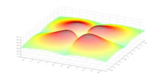

For $r=1$ and $s=2$ with $K=2$, the graph of $\psi_{r,s}(x)$ is displayed below:
Ratios of power norms
Here, the $\mu_{r,s}$ bound is reached. Yet numerically, with random vectors, I suspect that this bound is not tight in general. My questions are thus:
