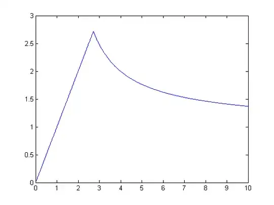

The equation can be rewritten as an expression for $y$ as a function of $x$,
$$ y(x) = \frac{-x}{\log{x}} W\left(\frac{\log{x}}{-x}\right), $$
where $W()$ is equal to Lambert W-function.
This function looks as follows:
which is linear ($y=x$) for $0<x<e$, after which it decays, with the limit,
$$ \lim_{x\to\infty} y(x) = 1. $$
Thus the range of $y(x)$, for which $y\neq x$, is $1\leq y<e$. The only integers within this set are $1$ and $2$, but the corresponding $x$ value for $y=1$ is $\infty$, thus $(4,2)$ is the only integer solution for $x>0$.
