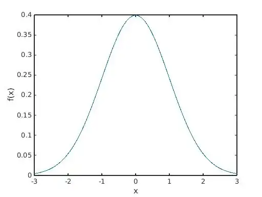

More rigorously, I could alternatively say that $f$ is the Radon-Nikodym derivative of the distribution measure of $X$ w.r.t. the Lebesgue measure on $\mathbb{R}$, or $f = \frac{\mathrm d \mu_X}{\mathrm d\lambda}$. As I understand it, $f$ re-weights the values $x \in \mathbb{R}$ in such a way that $$ \int_B \mathrm d\mu_X = \int_B f\, \mathrm d\lambda $$ for all Borel sets $B$. In particular, the graph of $f$ lies below one everywhere: normal pdf
so it seems like $f$ is re-weighting each $x \in \mathbb{R}$ to a smaller value, but I don't really have any intuition for this. I'm seeking more insight into viewing $f$ as a change of measure, rather than a sort of distribution describing how likely $X$ is.

    "In particular, the graph of $f$ lies below one everywhere" It does, and this fact is completely irrelevant. PDFs often take values above $1$ (to begin with, gaussian PDFs with variance small enough). – Did Jul 25 '15 at 19:11
  • @Did I was just trying to work with a concrete example. Do you think it would be more insightful to be more general? – bcf Jul 25 '15 at 19:24
  • Dunno--but why did you mention the fact in the first place? – Did Jul 25 '15 at 19:25

Your intuition for the measure $d\mu = f d \lambda$ is very reasonable and it is interesting to note how the function is distributed. How much area it has acumulated between $-1$ and $1$ at which point $f(x) = e^{-x^2/2}/{\sqrt{2\pi}}$ goes from concave to convex (f''(x)=0). Since $$f''(x) = \frac{1}{\sqrt{2\pi}} \bigg(-e^{-x^2/2} + x^2e^{-x^2/2}\bigg) = 0 $$
this means that at $x=1$ the curvature changes sign. Can you notice it in the graph?
It is also interesting to note that between $-2$ and $2$ you have accumulated more than $95\%$ of the total mass.
The fact that it is bounded by $1$ ($\frac{1}{\sqrt{2\pi}}$ to be precise) is also remarkable, but as you might have heard there is a family of normal variables and they are not bounded by $1$.
