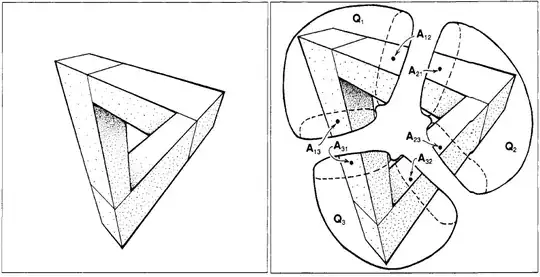

Penrose attaches a group to impossible figures to capture their inherent ambiguity, and I'd like to grok these groups like I do symmetry groups. Take a prototypical example, the tribar:
penrose tribar
He names the "ambiguity group" $G=\Bbb R^+$ (positive numbers under multiplication) to describe possible distances of points. We can split the figure up into three components, as above, and interpret them as being disconnected from each other in three-space but from our perspective they seem to make a single figure. For convenience, I think we should let $A_{ij}$ denote points on the figures as well as represent their distances from the origin, interchangeably.
One can define the relative distances by $d_{ij}=A_{ij}/A_{ji}$. Since $d_{ji}=d_{ij}^{-1}$, there are only three relevant proportions: $d_{12}$, $d_{23}$, and $d_{31}$. According to Penrose, the $d_{ij}$s do not actually depend on our choice of overlapping points $A_{ij}$, but this seems wrong to me: varying the points $A_{ij}$ through the overlap regions will change them linearly and so any ratio $d_{ij}$ will only remain invariant if $d_{ij}=1$ to begin with. But probably this quibble is unimportant.

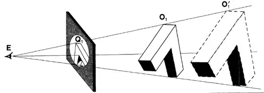

One can scale the distances the components $Q_1,Q_2,Q_3$ are from the origin without affecting our perception of them. (Perhaps consider our "perception" of them to be their radial projection onto the unit sphere, or something.) The effect of scaling one of these $Q_i$ by a factor of $\lambda$ on the $d_{12},d_{23},d_{31}$ is to scale one of them by $\lambda$, a second by $\lambda^{-1}$, and leave the third unchanged.
If the $Q_1,Q_2,Q_3$ were compatible and could be combined into a single figure, then such a configuration would have $(d_{12},d_{23},d_{31})=(1,1,1)$. If they were compatible but the components were separated by independent scalings $q_1,q_2,q_3$ (respectively) then we'd have
$$(d_{12},d_{23},d_{31})=\left(\frac{q_1}{q_2},\frac{q_2}{q_3},\frac{q_3}{q_1}\right). \tag{1}$$
Note that $\tau=d_{12}d_{23}d_{31}$ is an invariant, in the sense that scaling the components independently does not change the value of $\tau$. The compatibility situation $(1)$ occurs precisely when $\tau=1$.
Penrose defines the group $H$ to be the tuples $(d_{12},d_{23},d_{31})\in(\Bbb R^+)^3$ modulo the rescalings by $\lambda$ and modulo the elements of the form $(1)$. As I understand it, the invariant $(d_{12},d_{23},d_{31})\mapsto\tau$ is a bijection $H\to\Bbb R^+$. But now here are my questions.

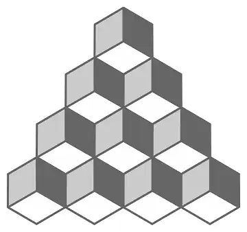

$\sf \color{Fuchsia}{(A)}$ How do we know what the ambiguity group is? The tribar's ambiguity group is $G=\Bbb R^+$. With the Necker cubes above, Penrose says the ambiguity group is $G=\Bbb Z_2$. Is the ambiguity group meant to parametrize the possible positions of the individual pieces of the figure? Where does the group operation of $G$ actually come into play?

To answer $\sf \color{Fuchsia}{(A)}$, one has to understand the meaning of the ambiguity group clearly first - indeed, your interpretation of the group is not entirely correct.
The punchline here is that the ambiguity group measures ambiguity, not quite impossibility (which is the job of the cohomology group defined later), of the given figure. For example, consider the tribar, and piece it up into $Q_1, Q_2, Q_3$, as done by Penrose. If you stretch $Q_1$ by a factor of $\lambda > 0$, shrink $Q_2$ by a factor of $\lambda$ (that is to say, stretch by $\lambda^{-1}$), and leave $Q_3$ as it is, the resulting object is really the same tribar, which is what Penrose was trying to convey through the following picture from the paper.
That is to say, modifying $Q_i$'s in this way gives you a symmetry of $X$. And you have such a symmetry for each $\lambda > 0$. Of course, collection of such symmetries $G$ is a group: consider one symmetry which stretches $Q_1$ by $\lambda$, shrinks $Q_2$ by $\lambda$ and leaves $Q_3$ as is and another one which does the same thing with $\lambda'$ this time instead. You can of course compose them, and the resulting symmetry stretches $Q_1$ by $\lambda \lambda'$, shrinks $Q_2$ by $\lambda \lambda'$, and leaves $Q_3$ invariant. This is the ambiguity group. This partially answers $\sf \color{Fuchsia}{(C)}$. Note that the origin of the name comes from the fact that the tribar is ambiguous in the sense that you can have different $Q_1, Q_2, Q_3$'s matching up to produce the same tribar. You can never tell the length of a bar in the tribar - it'll depend on the point of view you're seeing it from. And the "group of symmetries" $G$ captures all the ambiguity there is.
It is now clear that there is a bijection $G \to \Bbb R^+$, sending a symmetry to the corresponding $\lambda > 0$ in $\Bbb R^+$ (group under multiplication), which is in fact a homomorphism. Thus, $G \cong \Bbb R^+$.
That said, given the Necker cubes, the ambiguity is in the vertices. Pick any vertex $v$ from the figure. There are two point of views here - $v$ can either point upwards, or point downwards. If $v$ points upwards, then so does all the other vertices, and similar for the other choice. So two point of views, two choices - hence, the ambiguity group is $\Bbb Z/2\Bbb Z$. More formally, the symmetry is obtained from reflecting the whole figure (imagined as sitting in $\Bbb R^3$) along an appropriate hyperplane. Obviously, the symmetry group then is the cyclic group of order 2.

Let us compute the cohomology group of the tribar. $H^1(X;\Bbb R^+)$ is the group of $1$-cocycles modulo $1$-coboundaries. As there are no nontrivial $2$-cochains, every $1$-cochain is a cocycle. That is to say, we're computing $1$st cohomology of the two-term cochain $$0 \to C_0(X) \stackrel{\partial}{\to} C_1(X) \to 0$$ which is just $C_1(X)/\text{im} \partial$. Note that this has a slight similarity with your interpretation (the definition of $H$), but is not quite the same. In any case, I can find a $1$-cocycle in $C_1(X)$ which is not a coboundary using the clever technique devised by Penrose: the $1$-cochain $\psi^1$ sending $Q_{ij} = Q_i \cap Q_j$ to $d_{ij} = A_i/A_j$ is independent of the choice of $A_k$'s, and I claim that it is a nontrivial cochain (i.e., is not a boundary). Well, if it was a boundary, then the equality $d_{ij} = \psi^1(Q_{ij}) = \psi^0(Q_i)/\psi^0(Q_j)$ would hold for some $0$-cochain $\psi^0$. But then we'd have $\tau(\psi^1) = d_{12}d_{23}d_{31} = 1$.
However, if we choose the placement of tribar appropriately so that $A_{12}$ and $A_{21}$ has the same distance from origin (i.e., $d_{12} = 1$) and $A_{23}$ is farther away from origin than $A_{32}$ (so that $d_{23} > 1$, then $A_{13}$ would automatically be closer than $A_{31}$ (that is, $d_{31} = d_{13}^{-1} > 1$), which implies $\tau(\psi^1)$ is strictly greater than $1$, forcing $\psi^1$ to be nontrivial. Once we have this nontrivial cochain, we can get $|\Bbb R^+|$-many nontrivial cochains by multiplying $\psi^1(Q_{12})$ by $1$, $\psi^1(Q_{23})$ by $\lambda$, and $\psi^1(Q_{31})$ by $1/\lambda$ for each $\lambda > 0$. This gives a natural identification with $G$. I think with some work you can show that these are all the nontrivial $1$-cocycles there are, and conclude $H^1(X; \Bbb R^+) \cong \Bbb R^+$. In general, it need not be true that $H^1(Q; G)$ is the same as the ambiguity group $G$, but the $1$-st cohomology group $H^1(Q; G)$ would be a module over the ambiguity group $G$.

PS: I wanted to add an explicit computation of the Penrose cohomology $H^1(X; \Bbb Z/2)$ of the Necker cube as a summary, but I'd need some pictures for that and I'm too ashamed of my drawing skills to add it. Maybe if OP (and others reading this) are really interested.

  • For the Necker cube, you need to look at the sub-picture consisting of three of the cubes with each face of the three cubes making another cube. Then pick open covers to be appropriate thickening of three of the cubes (or so I think it is - I figured it out when I seriously thought about it, but have forgotten the details). The nontrivial cocycle comes from choosing vertices of the cubes to point inwards/outwards. I guess I should add a picture once I get free. – Balarka Sen Jan 09 '16 at 22:52

  • In fact, I think it's safe to say that the Necker cubes in OP's picture are not impossible (this agrees with the trivial cohomology groups idea). They are ambiguous, because there is a $\mathbb{Z}/2$ action that reverses the perception of the vertices, but the same can be said of any of the three separate rods of the tribar (where in that case the ambiguity lies in their perceived distance), which aren't impossible by themselves. The Necker cubes can be assigned a global choice of perception which is coherent. – Alex Provost Jan 10 '16 at 13:55
