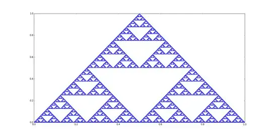

The basic example (euclidean-cartesian) requires three attractor vertices, $ABC$, and as Wikipedia explains: "The fractal is created by iteratively creating a sequence of points, starting with the initial random point, in which each point in the sequence is a given fraction of the distance between the previous point and one of the vertices of the polygon; the vertex is chosen at random in each iteration."
The sequence of points $(x,y)$ will produce the pattern of the Sierpinski attractor:
