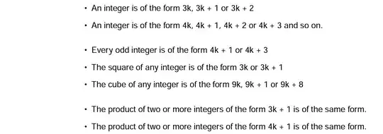

I have in my notes the form of the integers as: enter image description here
Now, I know that I have to use the division algorithim to prove the first form, and I can do this, but in the second form of an integer $4k$ isn't the "so on" redundant by the division alogirithim since there is no integer of the form $x=4k+4$ or does the "so on" simply imply that we can also have $5k, 5k+1....5k+4$ and $6k,6k+1...$?
