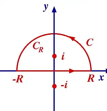

To find this, we will calculate the integral
$$ \int_{\Gamma_R} \frac{dz}{z^6+1}, $$
where $\Gamma_R$ is the semicircle of radius $R$ in the upper half-plane, $C_R$, together with the line segment between $z=-R$ and $z=R$ on the real axis.
(Image courtesy of Paul Scott.)
Then
$$ \int_{\Gamma_R} \frac{dz}{z^6+1} = \int_{-R}^{R} \frac{dx}{x^6+1} + \int_{C_R} \frac{dz}{z^6+1}. $$
We need to show that the integral over $C_R$ vanishes as $R \to \infty$. Indeed, the triangle inequality gives
$$\begin{align} \left| \int_{C_R} \frac{dz}{z^6+1} \right| &\leq L(C_R) \cdot \max_{C_R} \left| \frac{1}{z^6+1} \right| \\ &\leq \frac{\pi R}{R^6 - 1}, \end{align}$$
where $L(C_R)$ is the length of $C_R$. From this we may conclude that
$$ \lim_{R \to \infty} \int_{\Gamma_R} \frac{dz}{z^6+1} = \int_{-\infty}^{\infty} \frac{dx}{x^6+1}. \tag{2} $$
