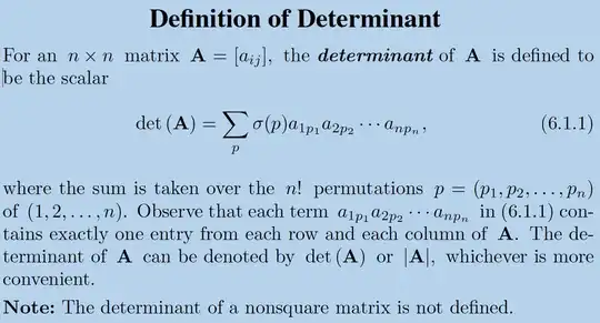

This is the Definition of Determinant

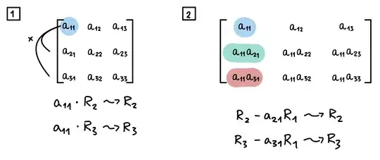

So for row reducing first we have to get zeros in the first column except in the first column, so we can use the row operation of multiplying a row by a scalar. In this case we multiply row 2 and 3 with the scalar $a_{11}$ and then we use the row operation of summing a row multiplied by a scalar, in this case for the second row it will $-a_{21} \cdot R1$ and for third row $-a_{31} \cdot R1$.
$$\begin{bmatrix} a_{11} & a_{12} & a_{13}\\ a_{11}a_{21} & a_{11}a_{22} & a_{11}a_{23} \\ a_{11}a_{31} & a_{11}a_{32} & a_{11}a_{33} \end{bmatrix} \sim \begin{bmatrix} a_{11} & a_{12} & a_{13}\\ a_{11}a_{21} - a_{11}a_{21} & a_{11}a_{22} - a_{12}a_{21} & a_{11}a_{23} - a_{13}a_{21} \\ a_{11}a_{31} - a_{11}a_{31} & a_{11}a_{32} - a_{12}a_{31} & a_{11}a_{33} - a_{13}a_{31} \end{bmatrix} $$
$$ \sim \begin{bmatrix} a_{11} & a_{12} & a_{13}\\ 0 & a_{11}a_{22} - a_{11}a_{21} & a_{11}a_{23} - a_{11}a_{21} \\ 0 & a_{11}a_{32} - a_{11}a_{31} & a_{11}a_{33} - a_{11}a_{31} \end{bmatrix} $$
So we can summarize this steps in a simple algorithm: enter image description here
This algorithm for getting zeros in the first column can be generalize for an $n \times n$ matrix such that the first step will be:
  1. Multiplying all the rows except the first one by the first entry of the first column.
  2. Adding to all rows except the first one by the $-a_{i1} \cdot R1.$

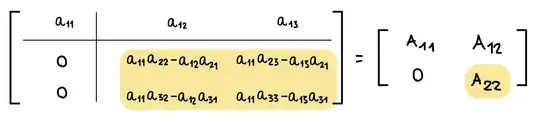

So we can apply again this algorithm to the next submatrix $A_{22}$: enter image description here
After applying the algorithm to the submatrix $A_{22}$ we get th echelon form of the matrix A: $$\sim \begin{bmatrix} a_{11} & a_{12} & a_{13}\\ 0 & a_{11}a_{22} - a_{12}a_{21} & a_{11}a_{23} - a_{13}a_{21} \\ 0 & 0 & (a_{11}a_{33} - a_{11}a_{31})(a_{11}a_{22} - a_{12}a_{21}) - (a_{11}a_{32} - a_{12}a_{31})(a_{11}a_{23} - a_{13}a_{21}) \end{bmatrix} $$

There is nothing to prove actually. What you wrote is the definition of the determinant, and therefore does not need any proof. A definition is just a convention (albeit formal and precise) so that everyone can agree on its meaning.
There are several equivalent ways to define the determinant of a matrix $A \in \mathbb K^{n \times n}$. One could be to define it recursively, starting from the case $n = 1$ or $n = 2$.
