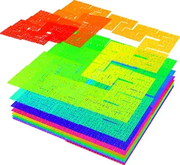

It is not hard to realize the unit square $[0,1]^2$ as the space at infinity. For example, if $\gamma\colon [0,1]\to[0,1]^2$ is a closed space-filling curve, let $S_\gamma$ be the following subset of $\mathbb{R}^3$. $$ S_\gamma \;=\; \bigl\{\bigl(x,\gamma(1/x-\lfloor 1/x\rfloor)\bigl) \;\bigl|\; x\in (0,\infty)\bigr\} \cup \bigl(\{0\}\times [0,1]^2\bigr) $$ The following picture shows a portion of this set in the case where $\gamma$ is the Moore curve.
The set $S_\gamma$ can be thought of as a variant on the topologist's since curve, with $\gamma$ playing the role of the sine function. Then $S_\gamma$ is closed in $\mathbb{R}^3$ and hence complete, and has a closed square as its space at infinity.
