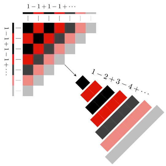

And for your second series $(1 - 1 + 1 - 1 + \dots)^2 = 1 - 2 + 3 - 4 + \dots = \frac{1}{4}$ Wikipedia gives this nice figure
Doesn't it seem obvious that $S5 = \frac{1}{2} S4$ ? However wikipedia gives the value $\frac{1}{2}$.
