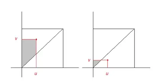

First, $$P(X_1<u,X_2<v, X_1\le X_2)= \begin{cases} -\frac{u^2}{2}+uv,&\text{ if }& 0\le u\le v \le 1\\ \frac{v^2}{2},&\text{ if }& 0\le v<u \le1 \end{cases}.$$
The figure below explains how I calculated the two pieces of surface area:
Second,
$$P(X_2<u,X_1<v ,X_2<X_1)=P(X_2<u,X_1<v, X_2\le X_1)= \begin{cases} -\frac{u^2}{2}+uv ,&\text{ if }& 0\le u\le v \le 1\\ \frac{v^2}{2},&\text{ if }& 0\le v<u \le1 \end{cases}.$$ (A figure similar to the one above would explain the latter result.) We can calculate the joint cdf: $$F_{Y_1,Y_2}(u,v)=$$$$=P(X_1<u,X_2<v, X_1\le X_2)+P(X_2<u,X_1<v ,X_2<X_1)=$$
