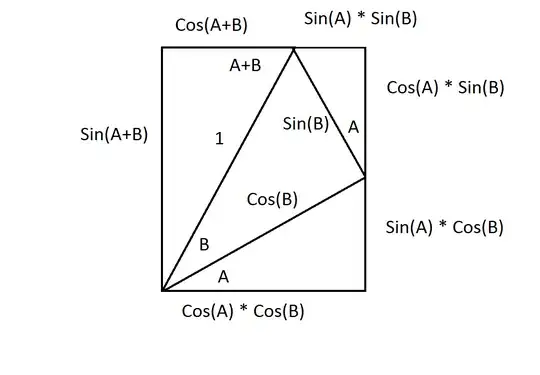

This was a nice geometric proof I learned when I took trig, enter image description here
Spencer
  • 12,691
