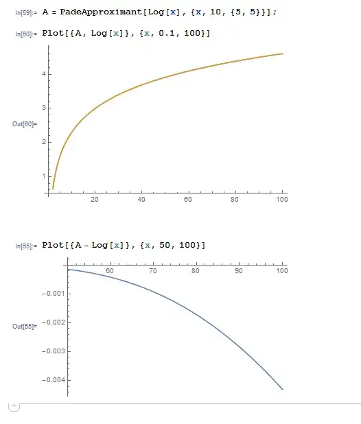

Is this good enough? It is within your specifications in 1 to 100
$$\frac{\frac{(x-10)^5 (137+30 \log (10))}{756000000}+\frac{(x-10)^4 (77+30 \log (10))}{2520000}+\frac{(x-10)^3 (47+30 \log (10))}{36000}+\frac{1}{450} (x-10)^2 (9+10 \log (10))+\frac{1}{20} (x-10) (2+5 \log (10))+\log (10)}{\frac{(x-10)^5}{25200000}+\frac{(x-10)^4}{84000}+\frac{(x-10)^3}{1200}+\frac{1}{45} (x-10)^2+\frac{x-10}{4}+1}$$
in plain text:
(Log[10]+1/20 (-10+x) (2+5 Log[10])+1/450 (-10+x)^2 (9+10 Log[10])+((-10+x)^3 (47+30 Log[10]))/36000+((-10+x)^4 (77+30 Log[10]))/2520000+((-10+x)^5 (137+30 Log[10]))/756000000)/(1+1/4 (-10+x)+1/45 (-10+x)^2+(-10+x)^3/1200+(-10+x)^4/84000+(-10+x)^5/25200000)

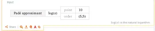

You can generate these yourself :
http://www.wolframalpha.com/input/?i=PadeApproximant%5BLog%5Bx%5D%2C+%7Bx%2C+10%2C+%7B5%2C+5%7D%7D%5D
Click the A button
If you want base 10, you would want to use Log10[x]
http://www.wolframalpha.com/input/?i=PadeApproximant%5BLog10%5Bx%5D%2C+%7Bx%2C+10%2C+%7B5%2C+5%7D%7D%5D
You are going to use this syntax to tune it yourself:
https://reference.wolfram.com/language/ref/PadeApproximant.html
Of course you have to you use a computer to actually evaluate this rational function. But if you already have a computer, why not just evaluate logx ?
