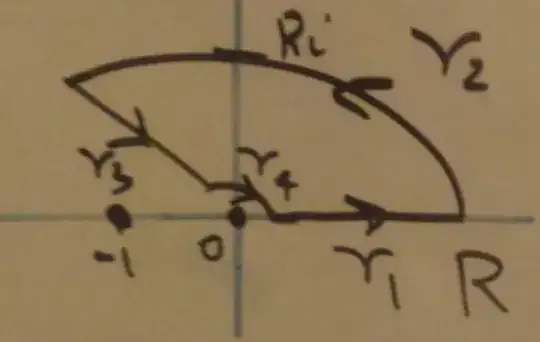

Consider the complexification $$f(z)=\frac{1}{z^{1/3}(1+z)}$$ where we choose the branch of the radical given by $$z^{1/3}=r^{1/3}e^{i\theta}, -\pi /2<\theta < 3\pi /2$$ (I'm open to using a different branch if convenient). The poles of $f$ are at $0,-1$, and I am not sure what contour I should use. I'm convinced that I am going to use a wedge, but I am not sure at which angle to make the wedge (that is, I am unsure of the angle of the line $\gamma_3$ lies on - see the pic below). In a different example that involved a square root, I was told "the angle should be twice the argument of the pole," but I have two poles; I don't know the argument of $0$ and if I double or triple the argument of $-1$, I land back on the real axis and my contour will have two overlapping sides or will intersect itself.

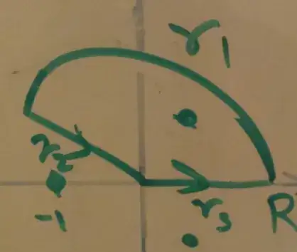

On the other hand, if we apply the $u$-substitution $u=x^{1/3}$, then $I$ becomes $$3\int_0^{\infty}\frac{u}{1+u^3}du$$, and the (complexification of the) integrand has poles at $-1,e^{\pi i /3}, e^{-\pi i /3}$. In this case, I am also unsure of how to determine the angle at which $\gamma_2$ should be (see pic below). I beleive the modified integral can be solved using partial fractions (and no complex analysis), but I prefer to use complex for now.
Question: How can I choose the right contour in each case, and should one always consider using a $u$-substitution when the integrand has rational powers of $x$?

  • Hint: the sector contour actually works (with angle $2\pi/3$), if you use $x=y^3$ first, so the integrand is unchaged up to a multiplicative constant on the returning radius. There is then exactly one enclosed pole. – J.G. Aug 16 '22 at 11:49
