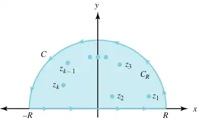

For integral i): $$\int_0^\infty \frac{\cos x}{x^2+a^2}=\Re\left[\frac 12\int_{-\infty}^\infty \frac{e^{ix}}{(x-ia)(x+ia)}\right]$$ We may choose the semicircular contour, $\Gamma$ from $-\infty$ to $\infty$, and also a line segment connecting those points. The line segment is what we want to evaluate. Therefore we have $I=\int_\Gamma -\int_{arc}$. We can prove the integral vanishes along the arc, i.e., it equals zero, and then use the residue theorem to evaluate $\int_\Gamma$.
