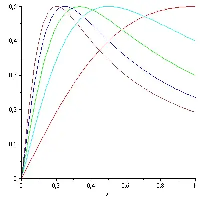

I am adding a graphic, so you can see what's happening as a response to your second question.
This is the graph of $f_1(x)$, $f_2(x)$,..., $f_5(x)$, from right to left. Note that the supremum is given by $\left(\frac{1}{n},f_n\left(\frac{1}{n}\right)\right)=\left(\frac{1}{n},\frac{1}{2}\right)$ and is moved to the left on each iteration, but always stays at 1/2.

  • You are welcome. You should see a discrepancy here: While the sequence of functions $f_n(x)$ go to 0 gradually, there exists one point ($x=1/n$) for which the function does not go to zero in the specified interval, because $f_n(1/n)=1/2$. Had your interval been $(a,1]$, with any $a>0$ instead, then convergence would be uniform in $(a,1]$. Can you see the difference? –  Jun 05 '15 at 20:03
  • I see that for $x=\frac{1}{n}$ the function sequence remains $\frac{1}{2}$. and therefore the function sequence doesn't converge to $0$ for all $x$. However, it seems weird to not have a fixed value for $x$. Is it "allowed" to let the point $x$ equal a varying point $\frac{1}{n}$? I have been trying to understand but unfortunately I don't see why convergence would be uniform on the interval $(a,1]$ :( – qmd Jun 05 '15 at 20:41
