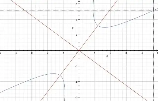

It may be more helpful to resolve the orientation issue using the double-angle formula for tangent, $ \ \tan(2\theta) \ = \ \frac{2 \ \tan \theta}{1 \ - \ \tan^2 \theta} \ $ . Working with the formula for the rotation angle of the conics, you have $ \ \tan (2 \theta) \ = \ - \frac{24}{7} \ $ (here, we don't worry about whether the numerator or the denominator should be negative), we obtain
$$ \frac{2 \ \tan \theta}{1 \ - \ \tan^2 \theta} \ \ = \ \ - \frac{24}{7} $$
$$ \Rightarrow \ \ 2 \ \tan \theta \ \ = \ \ - \frac{24}{7} \ + \ \frac{24}{7} \ \tan^2 \theta \ \ \Rightarrow \ \ 12 \ \tan^2 \theta \ - \ 7 \tan \theta \ - \ 12 \ \ = \ \ 0 $$
$$ \ \tan \theta \ = \ \frac{4}{3} \ , \ - \frac{3}{4} \ \ . $$
The ambiguity is unavoidable, but note that this gives the slopes of two perpendicular lines, one of which is the line for the "focal axis" of the conic section, the other being the perpendicular axis to that. This gives just two choices for eliminating the $ \ "xy" \ $ term in the conic equation. For this conic, which proves to be a hyperbola, the focal axis is along $ \ y \ = \ \frac{4}{3} \ x \ $ .
EDIT: It actually doesn't matter which choice you make for the slope of the line and the associated cosine and sine values, if all you want to do is eliminate the "mixed" term. The "correct" choice will rotate the axes so that the $ \ x'- $ axis runs through the conic's focal axis [ $ \ x'^2 \ - \ 4y'^2 \ = \ 4 \ $ ], while the "other" choice puts the $ \ y'-$ axis there [ $ \ y'^2 \ - \ 4x'^2 \ = \ 4 \ $ ]. (This is a point that I can't recall seeing mentioned in at least introductory texts. And most instructors don't have the patience to show the calculation worked out both ways...) If one desires to extract the properties of the conic, the differing alignments are not important.

  • I think it is safe to say that there is no need to "reconcile" the sign issue. As robjohn remarks in his answer, the function $ \ \cot(2 \theta) \ $ has a period of $ \ \frac{\pi}{2} \ $ , so the cotangent equation for the rotation angle of the conic generally has four solutions in the interval $ \ 0 \ \le \ \theta \ < \ 2 \pi \ $ . Two of these given angles of rotation put the focal axis on the conic on the $ \ x'-$ axis, whihe the other two angles lay the focal axis on the $ \ y'- \ $ axis . The textbook "correct" answer is one such choice, but not the only acceptable one. – colormegone Jun 06 '15 at 03:27
