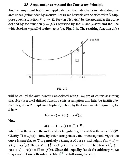

Taylor's Theorem
Using SIA a form of Taylor's theorem is exact since we choose $\epsilon^n = 0$
$$ f(x+\epsilon) = \sum_{k=0}^n f^{(k)}(x) \frac{\epsilon^k}{k!} $$
Therefore we can show the derivative of the exponential function is itself in SIA and expand:
$$ (e^x)'= e^x \hspace{0.125in}\text{ and }\hspace{0.125in} e^\epsilon = \sum_{k=0}^n \frac{\epsilon^k}{k!} \hspace{0.125in}\text{ or }\hspace{0.125in} e = \lim_{n \to \infty} (1 + \epsilon)^n $$
In general, this seems to be a way of obtaining infinite series as the Taylor series expansion and there is duality between $\epsilon \leftrightarrow n$.
COMMENT Upon further investigation, there doesn't seem to be any analogue of the Mean Value Theorem or Intermediate Value Theorem (which is provable in nonstandard-analysis). So in theory we can't prove:
Intermediate Value Let $a < b$ and $f(a) > 0$ and $f(b) < 0$, then there exists $a < c < b$ such that $f(c) = 0$ (False in $\mathbb{S}$)
This result breaks down in SIA - related to the Law of Excluded Middle. The Mean Value Theorem and (global) Taylor's Theorem seems to enjoy similar fates.
While we can take deritives (and integrals!) there doesn't seem to be any way to connect local and global information in the smooth world $\mathbb{S}$.
