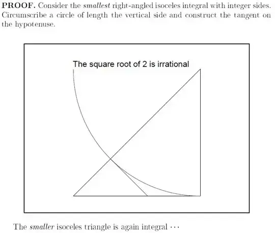

I want to add the following figure. I might not call it unusual but perhaps not common enough to be widely available.
Update: I later checked the image from wikipedia article (linked in comments to the current question) and it presents the same proof in a bit complex fashion. There is no need for two arcs. Just note that if $m$ is hypotenuse of larger triangle and $n$ is one of the other sides then after this construction the length of side of smaller triangle is $(m - n)$ (this is the obvious part). The slightly hard part is to show that the hypotenuse of smaller triangle is $(2n - m)$ and for this wiki article draws two arcs.
However we can easily see that tangents drawn from external point to a circle are of equal length. Hence both the tangents are equal to side of smaller triangle i.e. $(m - n)$. Hence the hypotenuse of smaller triangle is $(n - (m - n)) = 2n - m$.

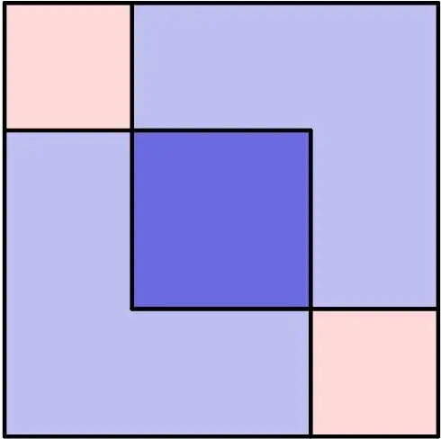

Tennenbaum gave a geometric proof of the irrationality of $\sqrt{2}$:
Tennenbaum's proof
The large square has side length $a$, while the light purple/blue square has side length $b$, with $a, b$ positive integers such that $({a\over b})^2=2$. But then it's easy to see that the blue square has twice the area of the pink square - that is, $({2b-a\over a-b})^2=2$. Since the numerator and denominator are each positive integers integers, and are less than $a$ and $b$ respectively, we have an infinite descent.
Noah Schweber
  • 260,658
