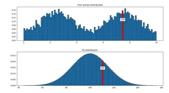

15
As Ron Maimon has said in the comments, the IQ scale is defined so that it gives a normal distribution with a mean of $100$ and a standard deviation of $15$. This is possible for any test score with a continuous distribution $f$. If the subject's score on the test is $s$, their IQ will be given by:
$$\text{IQ}=100+15\sqrt 2\;\text{erfc}^{-1}\left(2-2\int_{-\infty}^sf(x)dx\right)$$
To see that this gives a normal distribution, invert the equation above:
$$\int_{-\infty}^sf(x)dx = 1 - \frac{1}{2}\;\text{erfc}\left(\frac{\text{IQ} - 100}{15\sqrt 2}\right)$$
The left-hand side is the cumulative distribution function (CDF) of the test scores and the right-hand side is the expression for the CDF of a normal distribution.
It may sound weird to define IQ so that it fits an arbitrary distribution, but that's because IQ is not what most people think it is. It's not a measurement of intelligence, it's just an indication of how someone's intelligence ranks among a group:

From those quotes, you can deduce that any other information about the original distribution of scores in the actual test used to measure intelligence, like skewness and kurtosis, is simply lost.
The reason for choosing a Gaussian, and with those parameters, is mostly historical. But it's also very convenient. It turns out that you'd need about as many people as have ever existed to get someone to be ranked as an IQ of zero and someone else to be ranked as $200$ (roughly $1$ in $76$ billion). So in practice, IQ is limited to the interval $[0, 200]$ (no, there's no such thing as $300$ IQ. Sorry Sidis). Also, the dumbest person alive would have an IQ of $5$ and the smartest person $195$ ($1$ in $8.3$ billion). If you could theoretically apply the same test to trillions of people, then you'd get IQs above $200$ and even negative IQs. Obviously, the results will be different for different tests, and you might question whether any of the tests have really anything to do with actual intelligence.
To illustrate how you'd calculate IQ in practice, I made a Python script which takes an arbitrary distribution of scores in a test, generates a sample of $10$ thousand results and uses that to calculate the IQ of an additional participant based on their score in the same test. The plot shows the distribution of scores and how it's transformed into a normal distribution when converted to IQ. The score and IQ of the new participant are shown in red.

n, bins, patches = axes[0].hist( scores, bins=100, density=True, edgecolor='black') highlight_patch(new_score, patches, axes[0], '%.2f') x = np.linspace(scores[0], scores[-1], num=200) axes[0].plot(x, [scores_pdf(k) for k in x], ':') axes[0].set_title('Test scores distribution')
n, bins, patches = axes[1].hist( iqs, bins=100, density=True, edgecolor='black') highlight_patch(new_iq, patches, axes[1], '%.0f') x = np.linspace(iqs[0], iqs[-1], num=200) axes[1].plot(x, [gaussian.pdf(k, 100, 15) for k in x], ':') axes[1].set_title('IQ distribution')
fig.tight_layout() plt.show()
IQ_plot
