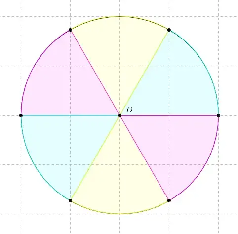

First divide the unit disk into equal sectors as shown below.
sectors
Notice that adding two vectors from opposing sectors results in a vector also in the unit circle. Since we can choose whether a vector is in a sector or its opposite (by possibly multiplying by $-1$), we can reduce the problem to the case $n=3$ (where each vector lies in a different colored area).
Peter Woolfitt's answer basically solves the problem. As he explains, we can reduce to the case $n=3$, where $\arg(z_1)$, $\arg(z_2)$ and $\arg(z_3)$ lie in $[0, \pi/3]$, $[2 \pi/3, \pi]$ and $[4 \pi/3,5 \pi/3]$ respectively. But, if $w$ and $z$ are in the unit disc and $2 \pi/3 \leq \arg(w) - \arg(z) \leq \pi$, then $w+z$ is in the unit circle. This will apply for one of the three pairs $(z_1, z_2)$, $(z_2, z_3)$ and $(z_3, z_1)$ so we reduce to $n=2$.
Possibly replacing $z_2$ by $-z_2$, we can assume that $z_1$ and $z_2$ make an obtuse angle with each other. Then $|z_1+z_2| \leq \sqrt{2}$, as desired.
