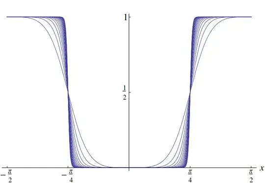

Another point of view, just to point out what's going on with the integral:
Consider the integral written in the form:
$$I(2k) = \int^{\pi/2}_{-\pi/2} \frac{1}{1+\cot^{2k}{x}} \, \mathrm{d} x, $$ and look at what happens with the integrand as $k$ goes to $\infty$ (in your case, $k = 512$):
where I have ranged $k$ from $2$ to $20$. Can you infer an asymptotic behavior of $I(2k)$ as $k \to \infty$?
Cheers!
Edit: I was fascinated by the fact pointed out by @enzotib. In fact, this may suggest that $\partial I/\partial k = 0$. Let's compute the derivative of the integrand w.r.t. $k$:
$$ \frac{\partial}{\partial k} \frac{1}{1+\cot^{2k}{x}} = -\frac{2 \cot ^{2 k}(x) \log (\cot (x))}{\left(\cot ^{2 k}(x)+1\right)^2} =:f.$$ We observe that $f$ is only defined for $x > 0$ and, as a matter of fact, it's an odd function with respect the line $x = \pi/4$ for all $k$. Therefore, $F= \int^{\pi/2}_{-\pi/2} f \, \mathrm{d} x= 0$ for every $k$, meaning that $I$ does not depend on $k$. Since $F = \partial I / \partial k$, on integrating $F$ with respect to $k$, we can see that $I = c$, for some constant $c$. To determine the value of $c$, we plug any value of $k$ in $I$ to have that $I = I(0) = \int^{\pi/2}_{-\pi/2} \mathrm{d}x /2 = \pi/2$.
