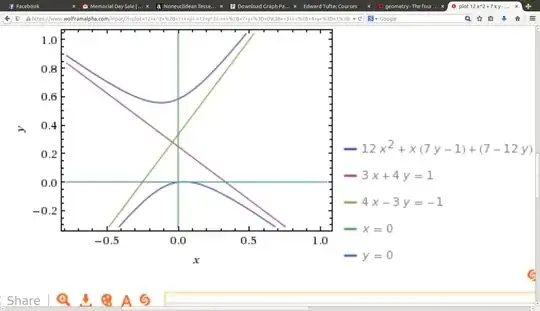

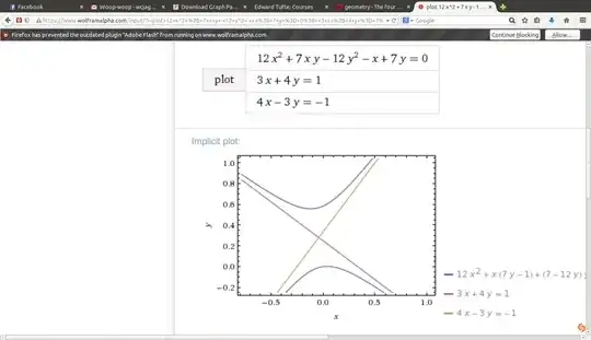

As I wrote in comment, your second equation does come out to two lines, as everyone pointed out. If we slightly alter it we get a hyperbola , $$ 12 x^2 + 7 xy - 12 y^2 - x + 7 y = 0, $$ which passes through the origin and is asymptotic to your two shifted lines, which now cross each other at $(-1/25, 7/25)$
enter image description here Here it is including the $x,y$ axes

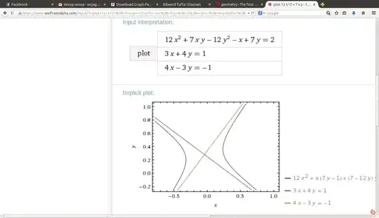

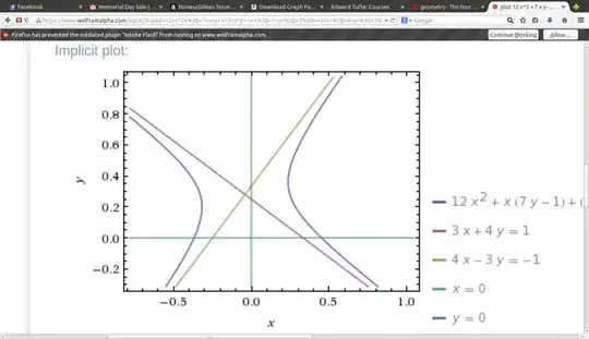

If we alter the constant in the other direction, we get a different hyperbola but still asymptotic to those lines,
enter image description here Here is this one with axes
