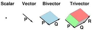

Given two vectors $\vec u$ and $\vec v$, the bivector $\vec u \wedge \vec v$ is the oriented area element whose magnitude is given by the area of the parallelogram with sides as the vectors $\vec u$ and $\vec v$ and with orientation given by the order of the factors in $\vec u\wedge \vec v$.
Likewise, the trivector $\vec u \wedge \vec v \wedge \vec w$ is the oriented volume element whose magnitude is given by the volume of the parallelepiped with sides as $\vec u$, $\vec v$, and $\vec w$. Higher dimensional $n$-vectors are defined analogously.
Here's a picture which might help you visualize it:
Thus $e_1 \wedge \cdots \wedge e_n$ is a unit $n$-vector -- that is an $n$-dimensional box with an $n$-volume of $1$ and an orientation defined by the order of the elements $e_i$.
