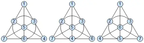

Now, the given identity involves a circular order on the seven roots of the septic. Up to symmetry, there are only three possible circular orders on the points of the Fano plane, corresponding to the three elements of $D_7\backslash S_7/L(7)$. (This result was computed in $\textsf{GAP}$.) Bijections of the Fano plane with $\{1,\ldots,7\}$ corresponding to these orders are shown below.
Thus, we may assume that the Galois group contains the symmetries of one of these three Fano planes.
Before tackling these cases individually, observe in general that the pointwise stabilizer of a line in the Fano plane is a Klein four-group, where every element is a product of two transpositions. For example, in the first plane, the symmetries that fix $1$, $2$, and $7$ are precisely $(3\;4)(5\;6)$, $(3\;5)(4\;6)$, and $(3\;6)(4\;5)$. These are the only sorts of elements of $L(7)$ that we will need for the argument.
Cases 1 and 2: In each of the first two planes, $\{3,5,7\}$ is a line, and thus $(1\;2)(4\;6)$ is an element of $L(7)$. Applying this permutation to the roots in the equation $$ x_1 x_2 + x_2 x_3 + \dots + x_7 x_1 – (x_1 x_3 + x_3 x_5 + \dots + x_6 x_1) = 0 $$ and subtracting from the original yields the equation $$ (2x_1-2x_2-x_4+x_6)(x_7-x_3) \;=\; 0. $$ Since $x_3\ne x_7$, we conclude that $2x_1 + x_6 = 2x_2+x_4$. Now, no three of $1,2,4,6$ are collinear in either of the first two planes. It follows that there is a symmetry of each of the planes that fixes $1$ and $6$ but switches $2$ and $4$, namely $(2\;4)(3\;7)$ for the first plane and $(2\;4)(5\;7)$ for the second plane. Thus we have two equations $$ 2x_1 + x_6 = 2x_2+x_4,\qquad 2x_1 + x_6 = x_2+2x_4, $$ and subtracting gives $x_2=x_4$, a contradiction.
Case 3: The argument for the last plane is similar but slightly more complicated. Observe that each of the following eight permutations is a symmetry of the third plane: $$ \text{the identity},\qquad (2\;7)(3\;4),\qquad (3\;6)(5\;7),\qquad (1\;3)(4\;5) $$ $$ (1\;2)(3\;6),\qquad (3\;7)(5\;6),\qquad (3\;5)(6\;7), \qquad (1\;2)(5\;7) $$ We apply each of these permutations to the equation $$ x_1 x_2 + x_2 x_3 + \dots + x_7 x_1 – (x_1 x_3 + x_3 x_5 + \dots + x_6 x_1) = 0, $$ adding together the first four results, and then subtracting the other four results. According to Mathematica, this gives the equation $$ 5(x_2-x_1)(x_3-x_5+x_6-x_7)=0. $$ Since $x_1\ne x_2$, it follows that $x_3+x_6=x_5+x_7$. As in the last case, observe that no three of $3,5,6,7$ are collinear, so there exists a symmetry of the plane that fixes $3$ and $5$ and switches $6$ and $7$, namely $(6\;7)(1\;4)$. This gives us two equations $$ x_3+x_6=x_5+x_7,\qquad x_3+x_7=x_5+x_6 $$ and subtracting yields $x_6=x_7$, a contradiction.
