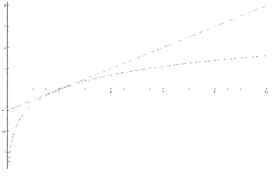

If you want computer accuracy, you can use numerical methods. Find a root of $f(x) = c - e^{ax} - e^{bx}$ using, for instance, Newton's method. But analytically I have not much hope. There is one thing you could do though : using the Taylor expansion of $e^x$, $$ 0 = e^{ax} + e^{bx} - c \ge (1 + ax) + (1 + bx) - c = (2-c) + (a+b) x, $$ which gives you a rough upper bound on $x$ like this : $$ x \le \frac{c-2}{a+b}. $$ I have no idea how to get a lower bound though. Note that this bound feels very crappy after you give some though about it ; fix $a=b=1$, which means you're trying to solve $2e^x = c$, which means $e^x = c/2$ and $x = \log(c/2) < \frac{c-2}2$. Here's an idea of how crappy this bound is :
We see that for $c > 4$, it's already very crappy. Anyway.
