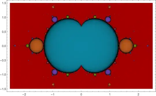

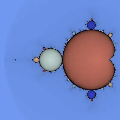

From a broader perspective, the point at $\infty$ is an example of a super-attractive fixed point and the dichotomy above is quite coarse - either, the critical orbit converges to infinity or it does not. At a somewhat finer level, we might ask what types of periodic behaviors can the critical orbit display? That is, we could iterate from the critical point zero and stop iterating if periodicity is detected. Note that this includes the possibility of convergence to $\infty$. We then shade the point $c$ according to the detected periodicity and the amount of time that it took to find that periodicity. This leads to an image of the Mandelbrot set that looks like so:
Now, you are studying a different family of functions, namely $g_c(z)=c\cos(z)$. Your function, of course, is not a polynomial; rather, it is an entire transcendental function. That is, it is differentiable on the entire complex plane but not at infinity. Iteration of such functions has been studied fairly well by researchers such as Devaney, Bergweiler, and Eremenko. There are similarities to polynomials but also crucial differences. In particular, the point at $\infty$ is an essential singularity; there's no reason to consider convergence to $\infty$ as important. While boundedness of the critical orbits might be relevant, this is mainly a byproduct of the fact that we are interested in attractive periodic orbits which are, of course, bounded. Also, there are infinitely many critical points. Fortunately, there are only two critical values, $\pm c$, which (by the evenness of the cosine) happen to have identical futures. Thus, you could simply iterate $g_c$ from zero and classify $c$ according to any periodicity that you detect. It's likely that there will be a large region where no periodicity is detected and you need a default color to indicate this situation. That's exactly how I generated the following image using red as the non-periodic color:

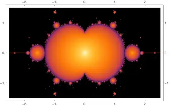

Note that this question has quite a lot in common with this one, which I also answered. Another answer to that question (which I think was quite good) suggested the use of Lyapunov exponents to classify the stability of the critical orbit. Applying that idea to your function, I came up with a picture like so:
