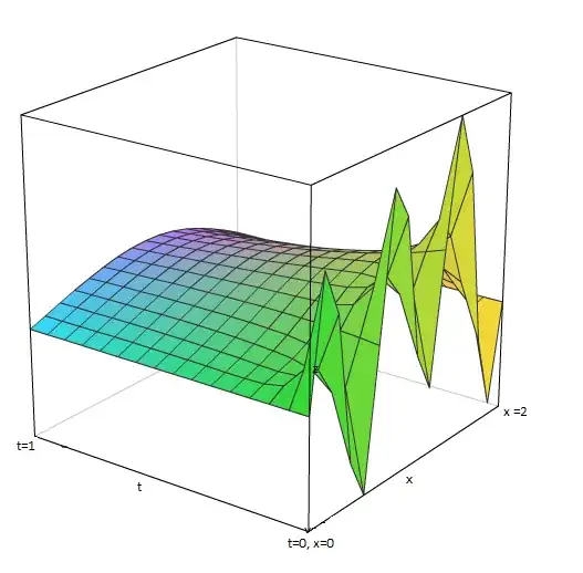

Graph of heat equation
Here is the graph, which I plotted between $x=0$ and $x=2$ with $t$ ranging from $0$ to $1$. you can see that near $t=0$ there are strong fluctuations in $x$ which quickly smooth out. The physical representation of this is large temperature gradients which would come into thermal equilibrium as heat flows using thermodynamic laws (well, as much as a system with two points that are held at temperature zero can be called a thermodynamic system). Eventually the function would be zero across the entire boundary as the limit of time tends to infinity.
