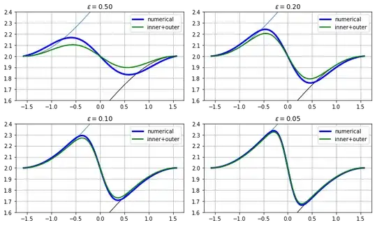

For $x_0=0$, $x=δX$, a first reduction of the singular equation removing non-essential infinitesimals reads as $$ ϵY''+2δ^2 XY'=δ^3 X. $$ Since $δ^3\ll δ^2$ the only non-trival case appears for $ϵ=δ^2$. The reduced inner equation is $$ Y''+2XY'=0\implies Y'=C·e^{-X^2}\implies Y(X)=C·\int_0^Xe^{-s^2}ds+D $$ with limits $Y(-\infty)=D-C·\frac{\sqrt{\pi}}2$ and $Y(\infty)=D+C·\frac{\sqrt{\pi}}2$.
Approximation formula
For the jump from $\frac52$ to $\frac32$ one needs $D=2$ and $C=-\frac{1}{\sqrt{\pi}}$ giving the total approximation as $$ y_{approx}(x)=2+\tfrac12\bigl(\sin x-\text{erf}(x/\sqrtϵ)\bigr) $$
The exponent for the boundary layer thickness is thus $\frac12$.
