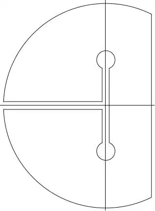

where $\gamma$ is the contour illustrated below.
Note that we have deformed the contour so as to avoid the branch points at $z=\pm i w$. The outer circular arc has radius $R$ and the arcs about the branch points have radius $\epsilon$.
I will for the time being assure the reader that the integrals over the outer arcs vanish in the limit as $R \to \infty$, and the integrals over the inner arcs vanish in the limit as $\epsilon \to 0$. Therefore, we consider the contour integral as the limit as $R \to \infty$ and $\epsilon \to 0$.
To do this, we must look carefully at the behavior of the log term on the dog-bone portion of the contour. Note that
$$\log{\left (1+\frac{w^2}{z^2} \right )} = \log{\left (1+i \frac{w}{z} \right )}+\log{\left (1-i\frac{w}{z} \right )} $$
We take the log to be the principal branch, so that the branch cut occurs for the arg of the arguments of the log equal to $\pi$.
The reader should note that there is a fourfold split here: when $z$ is to the left or right of the imaginary axis, and when $z$ is above or below the real axis. In each of these cases, the log has a negative argument, but the log of the negative argument takes on a different value along each section of the dog-bone.
When $z$ is to the left and right of the imaginary axis we respectively parametrize $z=+i y$and $z=-i y$. However, we subtract $i 2 \pi$ from the log term upon crossing the imaginary axis and add $i 2 \pi$ upon crossing the real axis.
The contour integral is then equal to
$$\int_{c-i \infty}^{c+i \infty} ds \, \log{\left (1+\frac{w^2}{s^2} \right )} e^{s t} + i \int_0^w dy \, \left [\log{\left (\frac{w^2}{y^2}-1 \right )}+i \pi \right ] e^{i y t}\\ - i \int_w^0 dy \, \left [\log{\left (\frac{w^2}{y^2}-1 \right )}-i \pi \right ] e^{-i y t} - i \int_0^w dy \, \left [\log{\left (\frac{w^2}{y^2}-1 \right )}+i \pi \right ] e^{-i y t}\\+ i \int_w^0 dy \, \left [\log{\left (\frac{w^2}{y^2}-1 \right )}-i \pi \right ] e^{i y t}$$
Note that the log terms all cancel, and we are left with
$$\int_{c-i \infty}^{c+i \infty} ds \, \log{\left (1+\frac{w^2}{s^2} \right )} e^{s t} + i 2 \pi (i) (i 2) \int_0^w dy \, \sin{y t} $$
By Cauchy's theorem, the contour integral is zero. Therefore, we may immediately write down the inverse transform as
$$\frac1{i 2 \pi} \int_{c-i \infty}^{c+i \infty} ds \, \log{\left (1+\frac{w^2}{s^2} \right )} e^{s t} = 2 \frac{1-\cos{w t}}{t} $$
