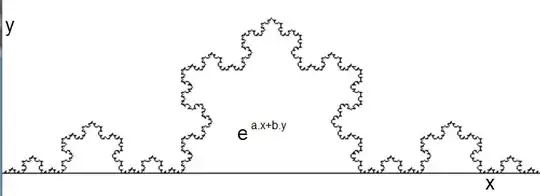

Grew out of frustration about this question; just replace "over" by "under":
What is $$ \iint_{K} e^{a \cdot x + b \cdot y} \,dx\,dy $$ integrated over the area between between the x-axis and the Koch curve. Assume that the Koch curve is between $(0,0)$ and $(1,0)$. It is common integration that is requested for, or at least an approximation to it. No fancy "measure" stories, just a method to calculate the integral, i.e. an algorithm or a series expansion (because it's reasonable to assume that there is no closed form).
A real number (approximation) for the case that $a=b=1$ would be nice, so that different outcomes can be compared.
