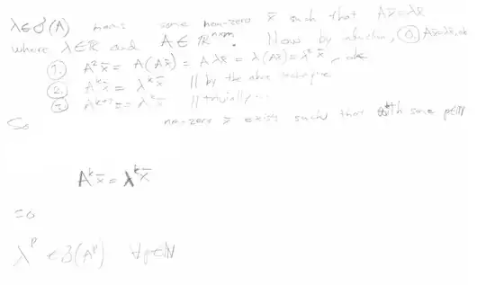

Suppose arbitrary $A$ so that $\lambda\in\sigma(A)$. By the definition of eigen-value, we have a non-zero $\bar{x}$ so that $A\bar{x}=\lambda \bar{x}$ where $\bar{x}\in\mathbb R^n$, $\lambda\in\mathbb R$ and $A$ is some matrix such that $A\in R^{n\times m}$.
Diversion I earlier abserved here, $A\bar{x_1}=\lambda_1\bar{x_1}$ so $A^2\bar{x_1}=\lambda_1^2\bar{x_1}$ so $A^k\bar{x_k}=\lambda_k^k\bar{x_k}$ so $\lambda_k\in \sigma(A^k) \forall k\in \mathbb N$.
Now I think I must somehow use that, thinking (sorry about bad quality but it is only meant for a very fast draft) -- basically the junk means use indunction after quantifying the terms and prove with direct proof.
Goal We need to prove that $\forall p\in\mathbb N : \exists \bar{x}\in\mathbb R \not =\bar{0} : A^p \bar{x}=\lambda^p\bar{x}$.
hhh

    Your goal is not quite right: you want to prove that $\forall p\in\mathbb{N}$ there exists $\overline{x}$ such that $A^p\overline{x}=\lambda^p\overline{x}$. (The $\overline{x}$ does not have to be the same for every $p$, although as it happens it can be; but, from a logical standpoint, this is not required). See this question for the difference between "there exists $\overline{x}$... for all $p$" and "for all $p$, there exists $\overline{x}$". – Arturo Magidin Apr 04 '12 at 21:54
  • It would be better to replace your 1, 2, and 3 by an actual proof by induction on $k$ (which is essentially what you are doing, but justifying it with hand-waving). Also, $\overline{x}$ is not in $\mathbb{R}$, and if you write $\overline{x}\in\mathbb{R}\neq 0$, then you are asserting that $\mathbb{R}$ is not zero, which is not what you mean. – Arturo Magidin Apr 05 '12 at 04:09
  • The solution given was like the draft in the above, perhaps I was just overengineering. – hhh Apr 15 '12 at 19:20

Remember the definition of "eigenvalue". Given a square matrix $B$, a scalar $\lambda$ is an eigenvalue of $B$ if and only if there exists a nonzero vector $\mathbf{x}$ such that $B\mathbf{x}=\lambda\mathbf{x}$.
If $\lambda\in \sigma(A)$, then that means that there exists a nonzero vector $\mathbf{v}$ such that $A\mathbf{v}=\lambda\mathbf{v}$.
In order to show that $\lambda^p\in\sigma(A^p)$, you need to show that there exists a nonzero vector $\mathbf{x}$ such that $A^p\mathbf{x}=\lambda^p\mathbf{x}$. The observation you make tells you which vector $\mathbf{x}$ you might want to select, and how to show that you do, in fact, get the desired equality.
If such a vector exists, then you are done: you've proven that if $\lambda\in\sigma(A)$, then necessarily $\lambda^p\in\sigma(A^p)$.
Your solution to the general case is poorly presented: you never specify that $\mathbf{x}_1\neq\mathbf{0}$, and a $\mathbf{x}_k$ appears ex nihilo in the final clause. What is $\mathbf{x}_k$?
