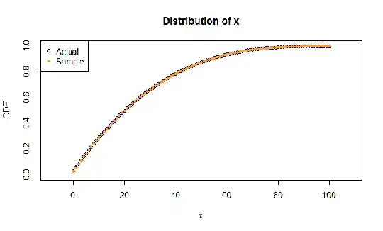

For $n=100$, $m=4$, compare the distribution of $x_i$ from samples generated from rcomp with the actual distribution.
n <- 100L
m <- 4L
r1 <- replicate(choose(n + m - 1, m - 1), rcomp(n, m))
r2 <- partitions::compositions(n, m)
all(colSums(r1) == n)
#> [1] TRUE
plot(ecdf(unlist(r2)), col = "blue", ylab = "CDF", main = "Distribution of x")
lines(ecdf(unlist(r1)), col = "orange", pch = 20)
legend("topleft", legend = c("Actual", "Sample"), col = c("blue", "orange"), pch = c(1, 20))
A couple notes: for relatively small $n$, as we have here, it will be faster to sample partitions::compositions(n, m) than to use rcomp. Also, rcomp will begin to experience numeric difficulties with large $n$. In this case, one approach could be to approximate the distribution with a discretized Dirichlet distribution, which is straightforward to sample. The discretization scheme can be implemented to ensure $\sum x_i=n$.
