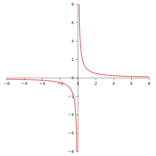

$1/x$ does tend to $-\infty$ as you approach zero from the left, and $\infty$ as you approach from the right:
f(x)=1/x
That these limits are not equal is why $1/0$ is undefined.
