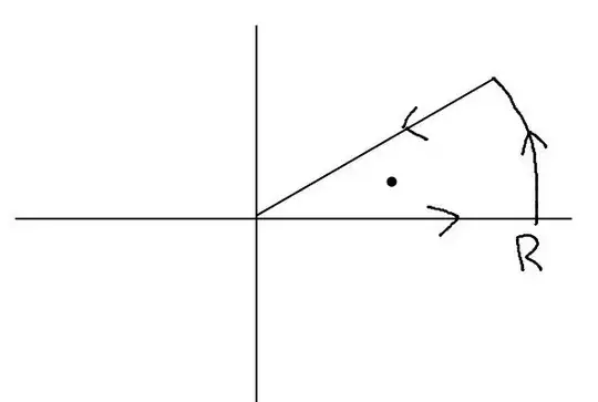

My conundrum- Since $n$ is an arbitrary positive even integer, I can't imagine we want to take a "typical" loop, (like the half circle of radius $R$, and then compute $n/2$ different residues), but instead we would want some kind of loop that singles out just one pole.

Take the following contour: $0 \to R \to Re^{i2\pi/n} \to 0$. In this case you have only one root inside. enter image description here
  • Should that be $R \to R e^{ i \pi/n}$? Would that not intersect one of the poles? (Namely $e^{i \pi/n}$?) Although if I did $R \to R{e^{2\pi i/n}}$ that might work quite well. Something to try, thanks! – mlg4080 May 05 '15 at 06:03
  • You are right, I've changed. – Nikita Evseev May 05 '15 at 06:08
