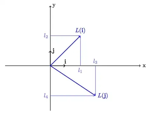

This is the simple answer and we can prove this statement simply using linearity. Here a proof in $\mathbb{R}^2$ that can be easely represented geometrically with a figure.
Let $\mathbf{i},\mathbf{j}$ the canonical basis and $\mathbf{v}=v_1\mathbf{i}+v_2\mathbf{j}$ a vector.
By definition a linear transformation $L$ acts as:
L(\mathbf{v})=v_1L(\mathbf{i})+v_2L(\mathbf{j})
Where $L(\mathbf{i})$ and $L(\mathbf{j})$ are vectors that we can represent as (see the figure):
L(\mathbf{i})=l_1\mathbf{i}+l_2\mathbf{j} \qquad L(\mathbf{j})=l_3\mathbf{i}+l_4\mathbf{j}
For another linear transformation $M$ we have:
$$ M(\mathbf{v})=v_1M(\mathbf{i})+v_2M(\mathbf{j}) $$ with $$ M(\mathbf{i})=m_1\mathbf{i}+m_2\mathbf{j} \qquad M(\mathbf{j})=m_3\mathbf{i}+m_4\mathbf{j} $$
Now, to show that $L$ and $M$ does not commute it is sufficient to show that $ML(\mathbf{i}) \ne LM(\mathbf{i})$. To show this fact calculate: $$ ML(\mathbf{i})=M(l_1\mathbf{i}+l_2\mathbf{j})=l_1M(\mathbf{i})+l_2M(\mathbf{j})=(l_1m_1+l_2m_3)\mathbf{i}+(l_1m_2+l_2m_4)\mathbf{j} $$ and, in the same manner, $LM(\mathbf{i})$.
You can do the same for $ML(\mathbf{j})$ and $LM(\mathbf{j})$. So you also see because a linear transformation is represented by a matrix.
