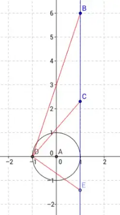

As commenters said, there is no nice bijection. Conceptually this is the same story as with bijections between closed and open intervals.
There is a natural bijection from the unit circle minus the point $(-1,0)$ to real line: $(x,y)\mapsto y/(x+1)$. Geometrically this is radial projection:
projection
Then you have to create room for $(-1,0)$. Use Hilbert's hotel: on the real line, send $n$ to $n+1$ for $n=0,1,2,3,\dots$. Then $(-1,0)$ can be mapped to $0$.
