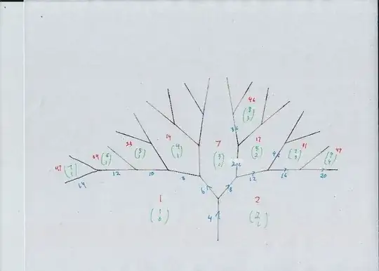

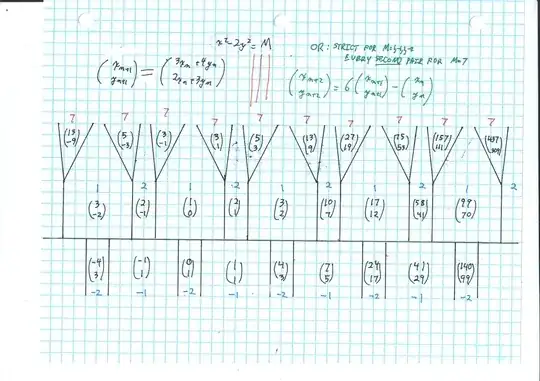

There is a method which gives all solutions, presented in CONWAY, chapter I. It is quick enough for targets of modest absolute value such as $49.$ The $(x,y)$ pairs in Conway's diagram are given more attention in STILLWELL, especially pages 87-100. I put those, as column vectors, in black in the first diagram, then light green in the second diagram.
To get quickly to the end, there are three families of solutions $$ (7,0), \; (21,14), \; (119,84), \; (693, 490), $$ $$ (9,-4), \; (11,6), \; (57,40), \; (331, 234), $$ $$ (9,4), \; (43,30), \; (249,176), \; (1451, 1026), $$ In all three cases there are linked recursions $$ x_{n+1} = 3 x_n + 4 y_n, $$ $$ y_{n+1} = 2 x_n + 3 y_n. $$
These give, by Cayley-Hamilton, separate recursions, $$ x_{n+2} = 6 x_{n+1} - x_n. $$ $$ y_{n+2} = 6 y_{n+1} - y_n. $$
