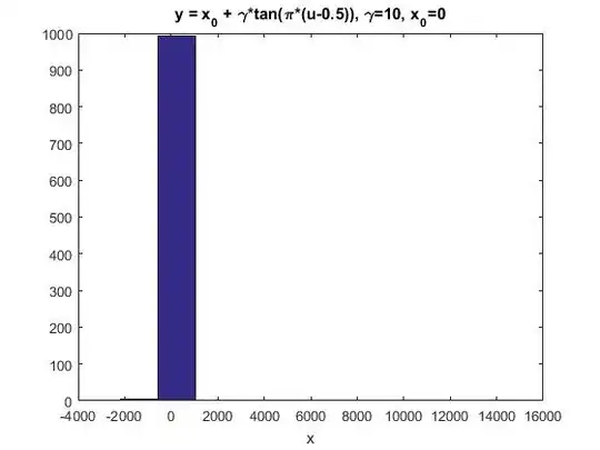

I got the result from the hist(r) as

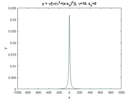

However, in second part of code where I plot the actual Cauchy distribution, I saw a very different shape as the first figure. Am I missing anything here?
  • You have run the simulation more than once, changed the bin widths, and so on, right? – Chappers May 03 '15 at 02:21
  • Sorry that I just started and I don't get your question. But I have prepared 1000 samples, each followed into [0, 1] as uniform random distribution. – user1285419 May 03 '15 at 02:25
  • You should probably set your bins manually rather than letting MATLAB do it in the default manner. For instance you might have a single bin for everything less than -1000, a single bin for everything greater than 1000, and 20 bins for things between -1000 and 1000. – Ian May 03 '15 at 02:38
First, as others have mentioned, you're using the default settings for the hist function. As stated right at the beginning of the documentation, this uses 10 equally-spaced bins by default. Try increasing the number:

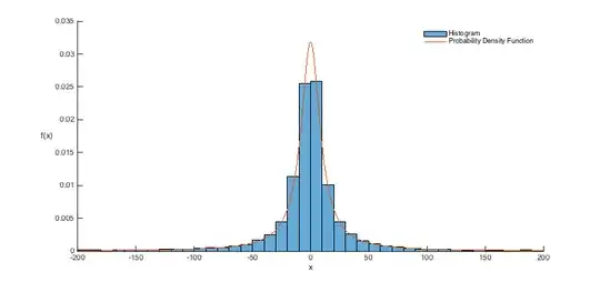

A better, more-flexible alternative is the histogram function, which does a better job of automatic binning even without specifying any additional settings. Additionally, it has options for easily normalizing the histogram as if it were a PDF, if that's what you're after
gam = 10;
x0 = 0;
u = rand(1,1e4);
r = x0 + gam.*tan(pi*(u-0.5));
edges = -200:10:200;
histogram(r,edges,'Normalization','pdf');
hold on;
x = -200:0.01:200;
y = (1/pi)*(gam./(gam^2+(x-x0).^2));
plot(x,y);
axis([x(1) x(end) 0 1.1*max(y)]);
This produces a plot like this: histogram plot

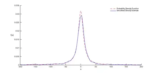

Lastly, you can use kernel density estimation via Matlab's ksdensity function:
gam = 10;
x0 = 0;
u = rand(1,1e3);
x = -200:0.01:200;
f = ksdensity(r,x);
plot(x,y,'r--',x,f,'b');
which yields a plot something like this:
ksdensity plot
More random samples will result in smoother estimates that match your PDF more closely. Be sure to read through the documentation for ksdensity.

Try to limit the range of your histogram. There are a small number of very extreme values in your Cauchy random sample that are causing the histogram to extend over a very large range, and at the same time causing almost all values to occupy one bin. Notice the density plot ranges only from -1000 to 1000. If you impose a similar range on your histogram (even better, make both plots run from -200 to 200), you won't have almost all your values living in one histogram bin, and the shape of the histogram will become more apparent.

  • I am trying to limit the range to be -100 to 100, in hisstogram, I still see a uniform distribution but in the real plot, I saw the big different plot. – user1285419 May 03 '15 at 02:28
